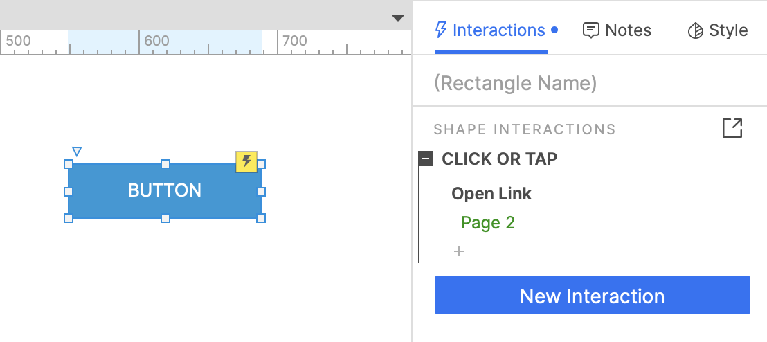

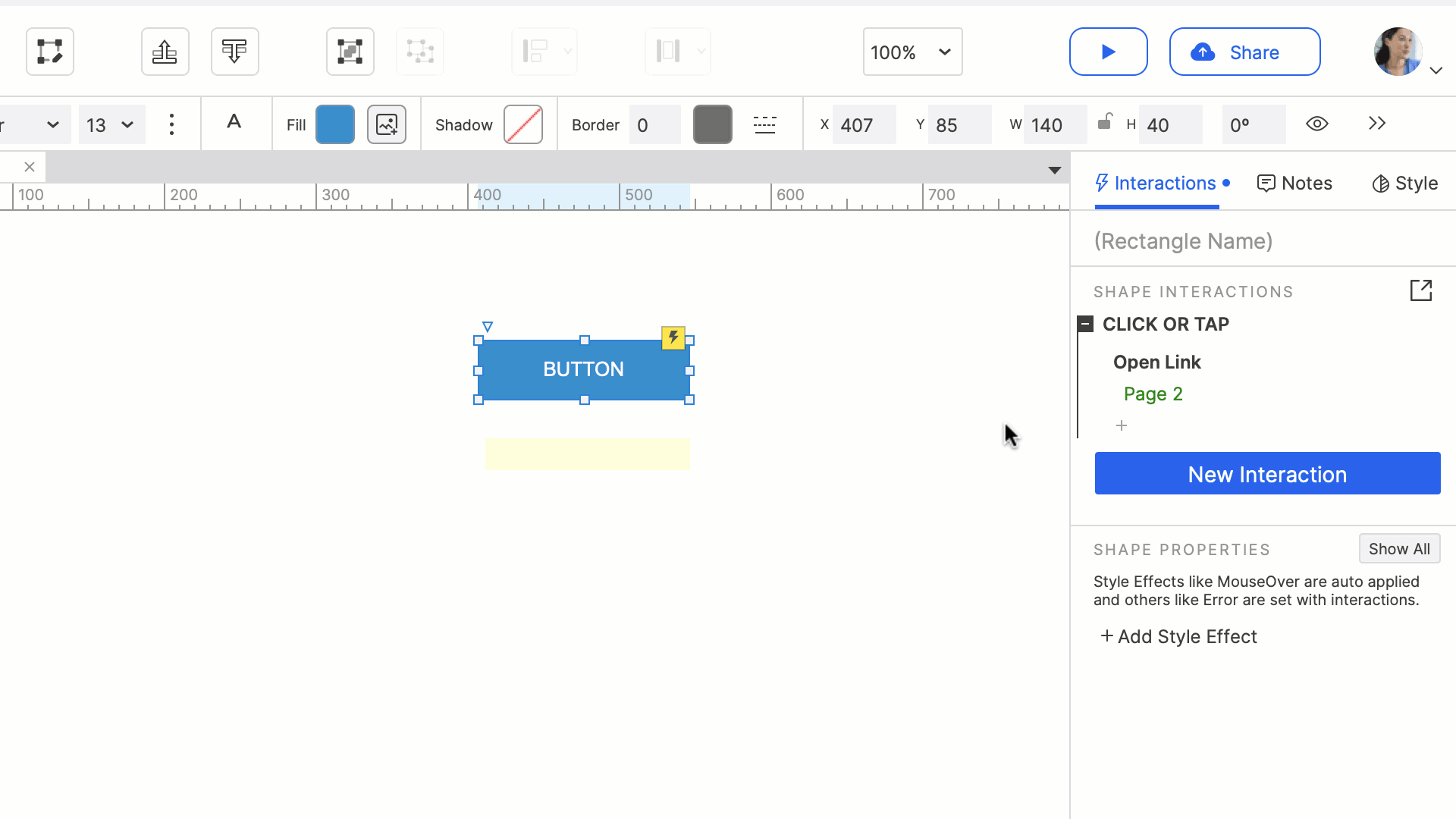

  3. Open Page 1 and add a Button widget.
  4. Select the Button widget and click New Interaction in the Interactions pane.
  5. Select the Click or Tap event.
  6. In the actions list, select the Open Link action.
  7. Choose Page 2 from the Link To dropdown and click OK.
  8. Click the Preview button to test out the interaction.

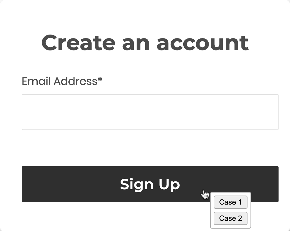

You can use Cases when you want an event to perform different actions depending on the scenario. For example, a login button may result in showing an error message or successfully signing in.

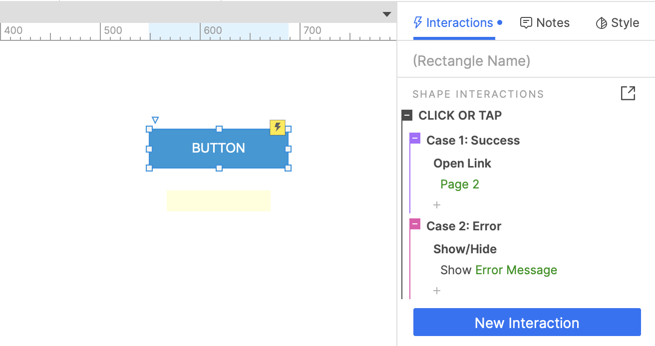

Once you have an interaction on a widget or page, follow these steps to add cases.
  1. Select the event and click Enable Cases next to the event.
  2. Name the first case.
  3. Click Add Case next to the event to add a second case and name it.
  4. Add actions to the second case by clicking the + button under the case.
  5. Click the Preview button to try it out. Triggering the event displays the case names and you can click one to perform the related actions.
