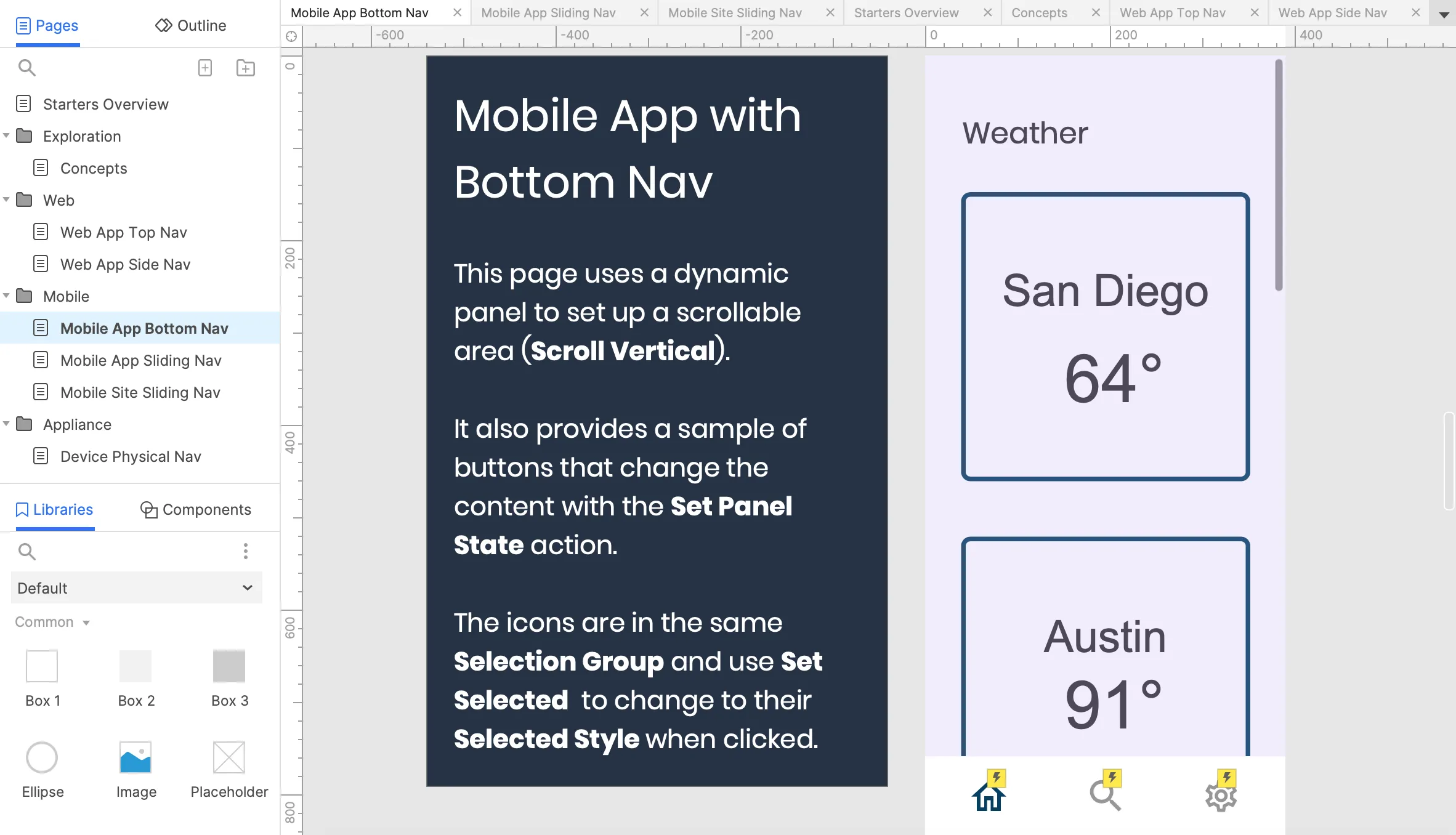

Axure RP's bread and butter is in creating rich interactive prototypes. Knowing that, we wanted to give users templates to jumpstart their prototyping and show different approaches to creating a prototype on Axure RP. We decided to go with an approach that leaned into dynamic panels because patterns that users want to create in Axure RP often require the dynamic panel. If you get comfortable with the dynamic panel in Axure RP, you can get a lot of value quickly from the tool. You'll notice that all of the templates use a dynamic panel but they are used in different design contexts.

From the structure of the pages within the project, you can begin to learn how you can structure a project within RP. You can have both concepts and your interactive prototypes in one project—that's one of the neat parts about RP—you can have various parts of your process available for consumption by stakeholders from one project link. You'll also learn about the various features that dynamic panels offer like being able to create scrollable regions by using a dynamic panel.

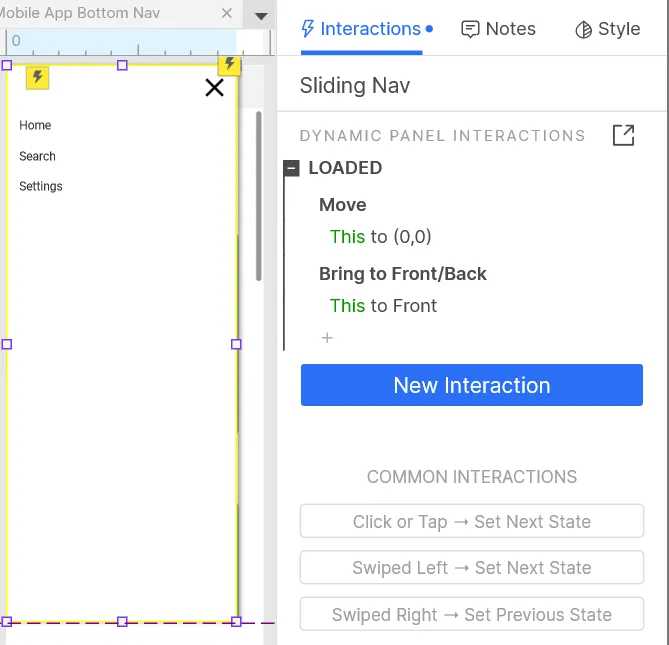

Expert users might adopt some tips and tricks we used in the template. For example, on the Mobile App Sliding Nav page, we layered the navigation on top of the "main content" on the page. However, the problem is, the navigation can get in the way if you ever want to edit anything behind it. So as users are working in RP, they can move it anywhere on the page and when previewing the prototype, the Loaded interaction will move it back to where it needs to be.
