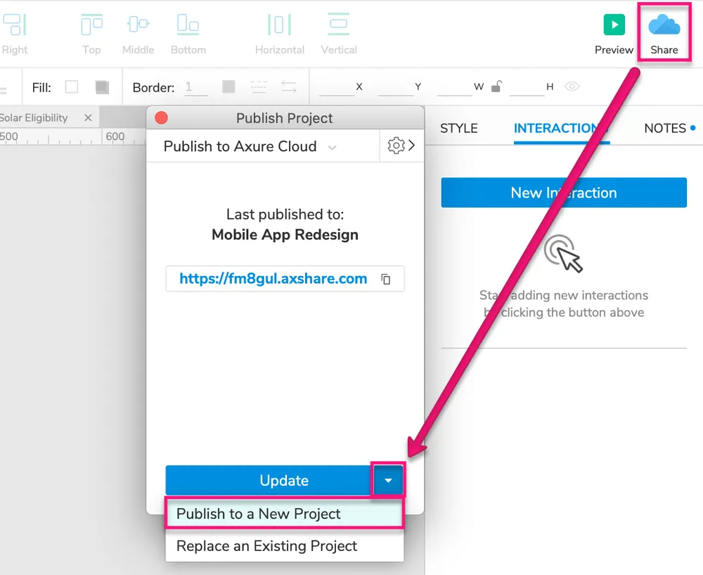

  1. Open your prototype in Axure RP and click the Share button at the top-right of the UI.
  2. Click the arrow next to the Update button and select Publish to a New Project.

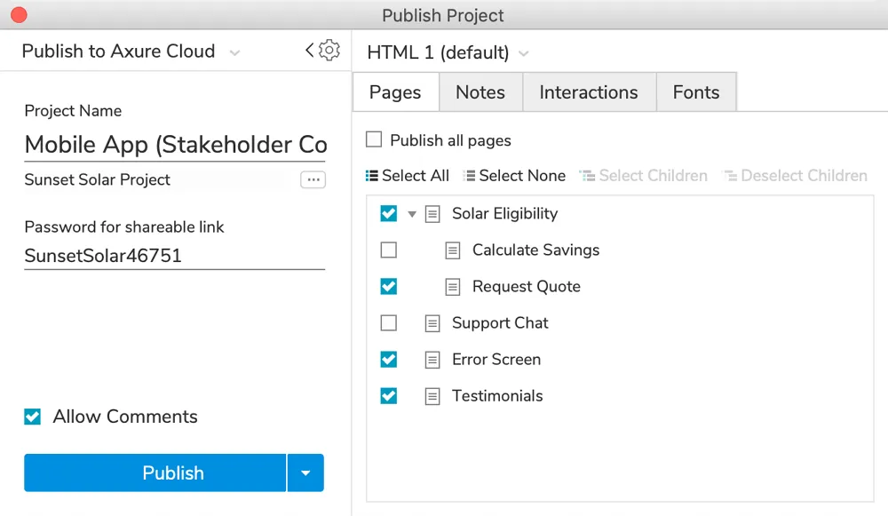

  3. At the top of the Publish Project dialog, click the gear button to choose which pages you want to publish. (You can make other publishing selections here as well.)
  4. Give the project a name that indicates the audience you're publishing for. For example, "Mobile App (Stakeholder Copy)".
  5. Add a password, if you'd like, and choose a workspace to publish the project in.

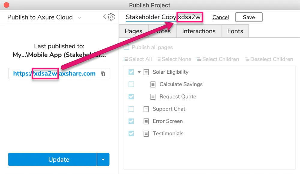

You can choose which pages to publish, whether or not to include page and widget notes, and a few other things by clicking the gear button at the top-right of the Publish Project dialog. You can change these selections on the fly whenever you publish, or you can save configurations that you use often. For example, you can save a configuration for each of your audiences:

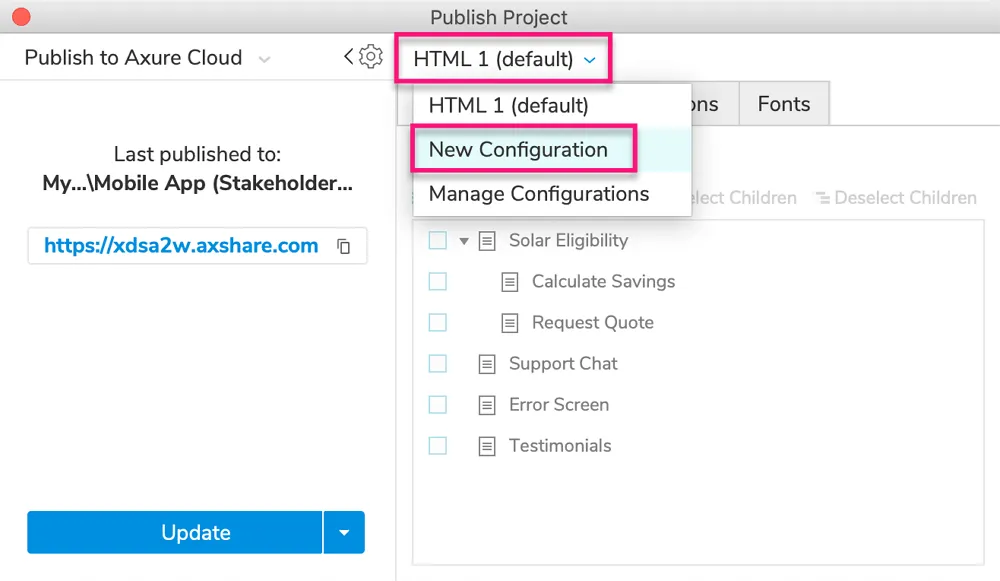

  1. At the top of the publishing settings, click HTML 1 (default).
  2. In the dropdown, select New Configuration.
  3. Give the configuration a name that includes the target audience as well as the six-digit ID of the Axure Cloud link you publish to for that audience. For example, "Stakeholder Copy xdsa2w". This makes it easier to find the correct configuration in the Publish Project dialog (Step 3 in the previous section).
  4. Click Save, and then make your publishing selections below.
